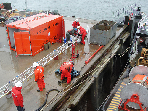

Once the USCG receives a report that there has been a collision and a crude oil spill has occurred, the USCG begins an assessment of the affected area. A VOSS (Vessel of Opportunity Oil Skimming System) is arranged to be deployed. These systems are pre-staged and packaged ready to be loaded on to a truck for delivery to a response. In the case of this years exercise, this VOSS system is located in New Hampshire, and trucked to Portland. Upon arrival, the system is loaded onto the 175 foot USCG buoy tender, Marcus Hanna, which is ideally suited for this system due to the design of the forward working deck of the Marcus Hanna. (data sheet)
Loading of equipment & assets aboard forward deck of the USCGC Marcus Hanna
full size above – full size below
VOSS has a system of containment booms as well as a pump that separates oil from water without emulsifying the oil. Once the oil is recovered, it is pumped into accompanying barges. Depending on ocean conditions, an oil recovery rate of over 90% can be achieved while processing 190 gallons of contaminated water per minute. Other state, local and private entities would also work at spill recovery, and shore clean up using response equipment such as aircraft, skimmers and containment booms.
