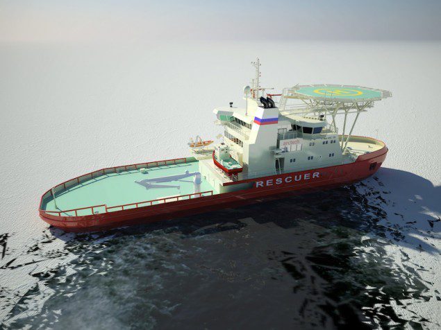

An illustration of the Baltika, which uses a patented “oblique” design to increase its virtual beam in order to create channels in the ice for ships with wider beams. Image (c) Arctech Helsinki Shipyard

The new vessel, named “Baltika”, features an asymmetric hull, with a patented oblique design and three 360 degree rotating propulsors, which allow the vessel to operate efficiently sideways, astern and ahead. In oblique mode the vessel will be able to generate a 50m wide channel in 0.6 m thick ice. Bow and stern first the vessel can operate in 1.0 m thick ice.

The vessel measures 76.4 m in length and 20.5 m in breadth. The three main diesel generator sets have the total power of 9 MW and the total propulsion power is 7.5 MW.
