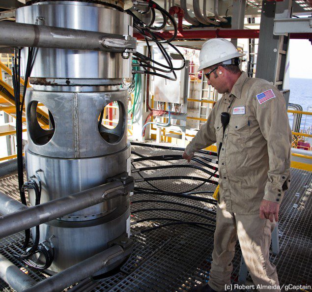

It’s a fairly high tech system. Not only does it handle all the incoming production and export lines, but it is also integrated with the electro-hydraulic umbilicals that control the subsea architecture a few thousand feet below on the sea floor.
The crazy part is that all these lines are built into a swivel system that allows the ship to spin around the buoy via its dynamic positioning system without leaking or damaging any of the pressurized piping or umbilical systems.
Production line swivel helix producer
Production line swivel within the DTS, click for larger (c) Robert Almeida/gCaptain
umbilical swivel helix producer fpu
Dean McFarlin points to one of the hydraulic lines leading into the umbilical swivel within the DTS, click for larger, (c) Robert Almeida/gCaptain
Pointing at the swivel, Dean comments, “There’s probably only 2 or 3 people who actually know how this swivel really works. It’s a closely guarded Helix secret.”
