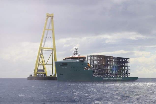

Damen Shipyards on Monday released information about an innovative new concept vessel designed as a smaller heavy transport, offshore installation and ro-ro platform versatile enough to be suitable in a number of markets.

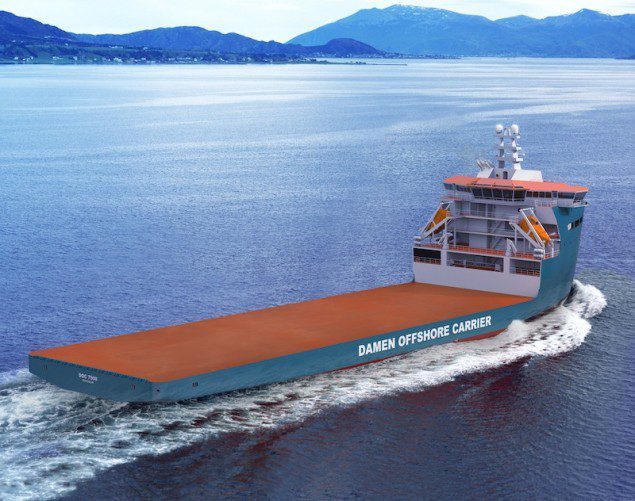

The Damen Offshore Carrier 7500, as the concept is known, was developed by Damen in cooperation with Singapore based heavy lift specialist Ha-Ce Engineering Pte Ltd.. The DOC 7500 has an endurance of 65 days, a large, flat and unobstructed deck of 2,300 m², a deck strength of 20 t/m² and is highly fuel-efficient.
The DOC has 2300+ m² unobstructed deck, free of any manhole etc., offering an efficient loading deck.

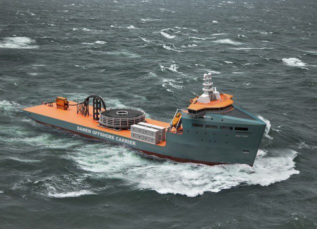

In the design process particular attention was paid to the bow and hull form. The new distinctive, sleek bow and slender hull enables the vessel to sustain its speed and course in head seas, as well as helping to reduce fuel consumption. The bow design diminishes accelerations and reduces slamming to a very low level, improving comfort and safety for the vessel, crew and cargo.

The DOC offers a platform that can be used for installation modules like cable laying, pipe laying, support works, etc. Modules can be placed during building stage or during operation.
A multifunctional ability was a key part of the DOC design. Damen was keen that it should find deployment in several markets, hence its suitability for shore-to-(off)shore transport, ro-ro operations and installation work.
The large unobstructed deck is free of any manholes, exhaust and de-aeration pipes. Ro-ro operations are unobstructed and modules can be stowed and secured everywhere on deck. An efficient ballast system and the ability to handle ro-ro over the stern and sides are other important advantages.

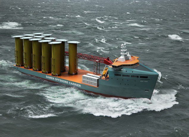

Transport & Installation
The DOC offers an excellent platform for transportation and installation works in the Offshore Wind and Tidal market. The solutions on deck for installation of wind turbine foundations are developed by Dutch Offshore Innovators BV and the feedering solution for nacelles is made possible by Barge Master BV.
The offshore wind and tidal energy markets are other focus areas. The Damen Offshore Carrier can be used in a feedering solution for offshore wind farms, transporting nacelles, transition pieces and monopiles. Its 2,300 m² platform with 20 t/m² load capacity can be used for a wide variety of offshore installation work such as cable laying, subsea installation, reel laying, floatover installation and other methods. For these purposes the vessel can be outfitted with all necessary installation equipment. This can be either a modular solution at a particular stage in the vessel’s operational life or an integral solution part of the initial shipbuilding process.

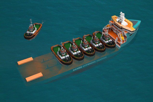

Submersible
The DOC has the ability to submerge as an additional loading feature. Vessel can be equipped with buoyancy casings to further optimise loading.
Yet another option is the DOC as a semi-submersible vessel, equipped with buoyancy casings. Additionally, the DOC can be fitted with a Damen Deep Dredge giving owners a deepsea dredging and mining solution up to 200 m water depth.

Currently the DOC is 27.5 m wide. Already Damen is considering a larger version of 32.5 m wide. The vessel has a Green Passport and a Zero Dumping certification and the fuel tanks are protected with cofferdams. The first DOC 7500 can be delivered in 2014.
The Particulars
Length overall 119 m
Length between perpendiculars 111 m
Length cargo deck 85 m
Breadth moulded 27.45 m
Depth to main deck 9.00 m
Draught design (approx.) 5.40 m
Draught scantling (approx.) 5.40 m
Deadweight at design draught (approx.) 7,400 t
Gross tonnage (approx.) 8,240 G T
Trial speed at design draught (approx.) 12.00 kn
