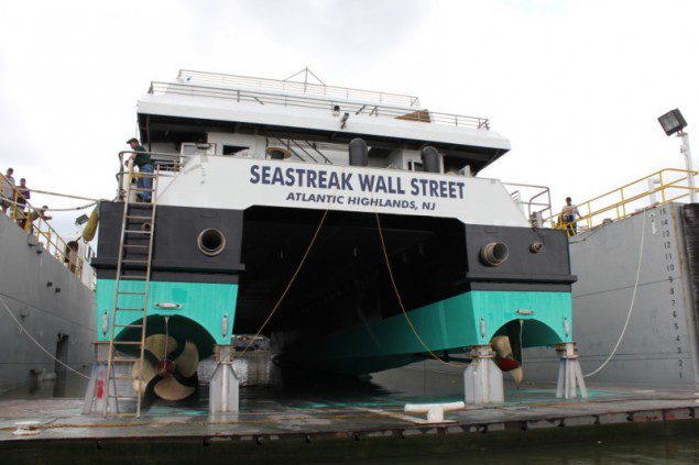

In August 2012, Incat Crowther completed a re-fit a re-fit of the Seastreak Wall Street, installing new engines and new controllable pitch propellers. Photo: Incat Crowther
In August 2012, Incat Crowther completed a re-fit of the Seastreak Wall Street, installing new engines and new controllable pitch propellers. Photo: Incat Crowther

Last weekend, the investigative team started to conduct static testing of the main engines and control systems. They also conducted an underwater survey of the vessel which revealed damage to the port propeller, but a more complete hull survey will be conducted when the vessel is hauled from the water for repairs. Also, at the request of the NTSB, the Army Corps of Engineers will conduct a bottom survey of the approach to Pier 11 to determine if there are any underwater approach obstructions.
Earlier last week, the controllable pitch propeller manufacturer (Servogear) arrived and worked with investigators to conduct testing of the propulsion system controls. In August 2012, Incat Crowther completed a re-fit of the Seastreak Wall Street, installing new engines and new controllable pitch propellers to replace the vessels original jet drives. These modifications reduced the vessel’s overall weight and reduced the top speed from 38 to 35 knots.

  1. As a damage to the port propeller was already revealed, I would strongly recommend to overhaul the port side CPP system so as to ascertain if any part in the hub was damaged. Also, please be noted.
    that in this two CPP system, without using the rudder, one could also use the two CPP system to operate the vessel. So, if it is the case, and the port side CPP system was damaged, then the steering of the vessel would fail to act as one's requirement and caused the crash.
