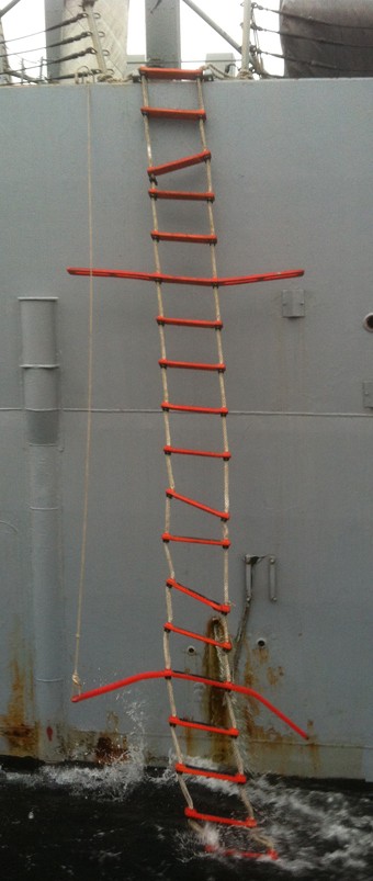

A few miles out to sea, the pilot boat operator approached the warship, but immediately noticed blatant safety issues needed to be corrected.  Noting the poor state of repair of the ladder hanging over the side, the pilot boat requested its replacement.
After the swapping out the bad ladder, the pilot began his climb up the vertical grey-painted steel.  Upon reaching the very top rung, disaster struck and the ladder slipped over the edge about 2 feet.
The knots tying it to the ship had failed.
Losing his footing, the Pilot held on to the ladder with one hand until finally his grip let go.  He fell approximately 18 feet to the wavetops.

We asked one of our subject matter experts to give us an analysis of the pilot ladder in the above image.   The following deficiencies were noted:
  1. The steps are misaligned and possibly damaged due to wear and tear
  2. The ladder is too long, should not be dragging in the water
  3. The lines are not taught
  4.  The sling that is tied off at the step that is used by the crew to pull the ladder up, is not tied off low enough.  Those things are difficult to pull in and if there is so much ladder below it, it is not only hard to pull up, but likely pretty dangerous.
  5. There is no hand rail at the top on the vessel for someone to grab onto as they are climbing up.
  6. There is no one at the top to assist or watch the person climbing up.
  7. The two rails that it is tied off from are both bent slightly the other way, never a good sign.
