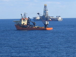

30 Days Sea Time
300px-Toisa_Perseus&Discoverer_Enterprise
The next portion to be completed is a MINIMUM of 30 days at sea onboard a DP equipped vessel.  Here you will get a chance to get some hands on experience in an operational environment.
