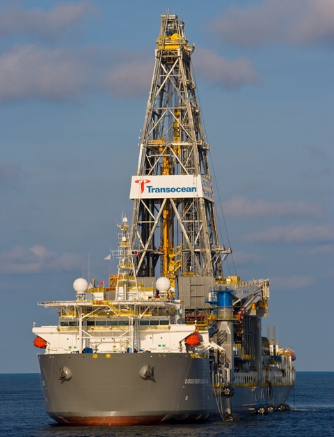

Since then drill ship technology has progressed through to todays 6th generation drill ships, such as the Discoverer Clear Leader.
DiscovererClearLeader
What are the DPO’s duties?
A drillship is connected to the sea floor most of the time.  The vessel needs to stay within a certain position radius to ensure that the angle on the drill string does not get too great.
The DPO pays close attention to the weather & prevailing conditions & ensure that the vessel stays on the minimum power heading when possible.  When the vessel automatically adjusts her heading to this effect it is known as “weather vaning”.
She will be equipped with a class 3 DP system, due to the large potential for environmental damage should something go wrong.
In a Red Light situation where the vessel is unable to hold position or is driving off, the drill string may have to be disconnected remotely.  This is a complex task, as the well needs to be shut, the landing string closed & pressure needs to be bled off before unlatching.
This could be potentially avoided if a quick thinking DPO sees the problem right when it occurs & is able to take steps to mitigate the severity.

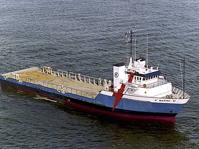

The workhorse of the offshore, these ships perform a variety of tasks, from setting or recovering anchors, to running all description of supplies between the beach & rigs or vessels offshore.
These vessels provide the drilling fluids, fuel & tools necessary for running the jobs offshore.  In some cases they act as Hot Shots, delivering critical supplies needed to keep the job running.
In other cases they spend long hours Standing By, either waiting to receive a load or just to support as needed.
kmarine_vi
Supply boats will normally be equipped with Class 1 systems, as the primary use is station keeping.  Much of the time spent on DP is just standing by in the field, waiting on the call.  Although the requirements differ from company to company, it is generally required to be used when coming alongside another vessel for cargo transfers.
The DP console will be stationed close to the aft bridge, so you can look out over the working deck.
Many companies these days specify that operations with the potential for damage to the environment, such as transfering fuel or other fluids, be carried out on DP, making its installation mandatory.
Working on supply boats can be a good way to obtain DP time when trying to obtain your license, however as it is a class 1 vessel the ticket will be Limited & you will still require some time onboard a class 2 or 3 vessel to complete the Training Requirements.
