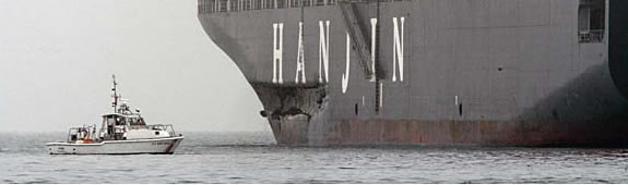

Cosco Busan Damage
Chronicle photo by Michael Macor
