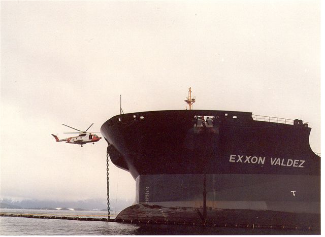

exxon valdezA common misconception of the public is that the Exxon Valdez grounding was the direct result of an intoxicated Captain. Those of us in the industry know this to be far from the truth. The truth behind that incident lies in a long accident chain with the most important link centered on Third Mate Gregory T. Cousins. But this post is not about the Exxon valdez it’s about an incident that happened while a third mate was navigating the Empress Of The North near the town of Juneau Alaska.

Compare this to the NTSB report of the Exxon Valdex:
“The third mate’s failure to turn the vessel at the proper time and with sufficient
rudder probably was the result of his excessive workload and fatigued condition,
which caused him to lose awareness of the location of Bligh Reef.”
