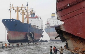

File photo of an Alang shipbreaking facility.
