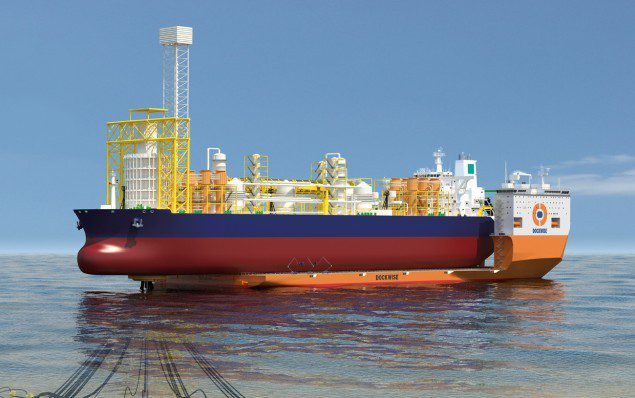

Moving on… the Dockwise Vanguard was a bit of a feature for you this year at OTC Houston, and your company is planning to do some remarkable things once she’s delivered, such as dry-docking an FPSO while still attached to the buoy.
dockwise vanguard fpso drydocking
A conceptual image showing the Dockwise Vanguard drydocking an FPSO while still connected to the production buoy, image courtesy Dockwise
How long has that concept been considered?
Really, we’ve been looking at this idea ever since we made the decision to build the Vanguard.  The idea behind this vessel is that it serves a couple of market segments.
