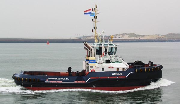

In November 2011 Iskes Towage & Salvage took its first Damen tug into operation: the ASD 2810 ‘Argus’. Pleased with its capabilities, Iskes decided to have Damen Shipyards Hardinxveld build a further two harbour tugs: the revolutionary ASD 3212 ‘Green Tug’, designed by Iskes and Offshore Ship Designers to reduce CO2, SOx and NOxemissions by 30%. The first contract was signed at Europort 2011 (Rotterdam) by managing directors Jos van Woerkum (DSHa), Jim Iskes and Michiel Wijsmuller (OSD). The tugs will be delivered by mid 2013.
