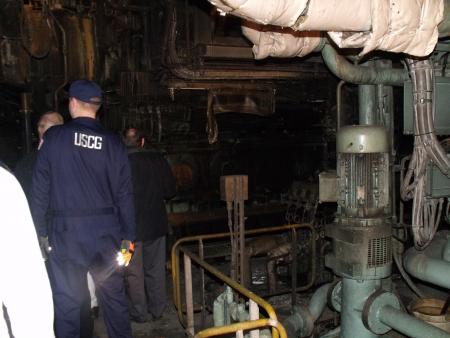

Coast Guard investigators from the Coast Guard Marine Safety Center and the Investigations Center of Expertise examine the cruise ship Carnival Triumph's engine room, Feb. 14, 2013, to determine the cause of a fire that broke out Feb. 10 and stranded the ship with its passengers for days in the Gulf of Mexico. Photo: USCG
Coast Guard investigators from the Coast Guard Marine Safety Center and the Investigations Center of Expertise examine the cruise ship Carnival Triumph’s engine room, Feb. 14, 2013. Photo: USCG

(Bloomberg) — The fire on Carnival Corp.’s cruise ship Triumph was caused by a leak in a fuel oil return line, the U.S. Coast Guard said.
The U.S. investigation of the causes of the incident and the crew’s response to the fire will last about six months, Lieutenant Commander Teresa Hatfield, the Coast Guard’s Marine Casualty Investigation team leader, said during a conference call with reporters today.
The ship, which left Galveston, Texas, on Feb. 7 with more than 3,100 guests, caught fire Feb. 10 off the coast of Mexico and arrived in Mobile, Alabama on Feb. 14, after being stranded for four days. The Coast Guard will also try to find out why the ship remained disabled for so long, Hatfield said.
