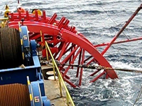

The pipe will be fed into the water off of a Stinger, which extends far past the stern. This allows the pipe to be controlled as it is deployed, as well as controlling the curvature made by the pipe as it enters the water.

Here is a video showing some flexible pipelay in action onboard the Lorelay
