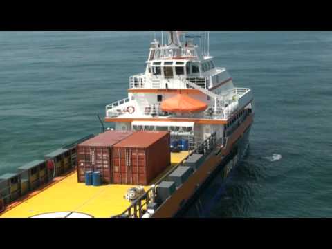

Here is a clip of the M/V Seacor Cougar while on DP
YouTube Preview Image
