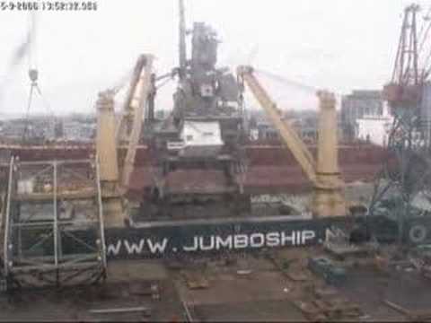

YouTube Preview Image
In 1978 Heerema had two semi-submersible crane vessels built, the Hermod and the Balder, each with one 2000 ton and one 3000 ton crane. Later both were upgraded to a higher capacity. This type of crane vessel was much less sensitive to sea swell, so that it was possible to operate on the North Sea during the winter months. The high stability also allowed for heavier lifts than was possible with a monohull.
