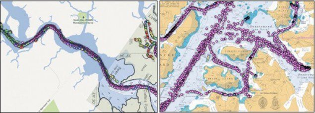

Sea Tow vessels in Coastal New Jersey (left) and expeditionary cruise ships in Antarctica (right) provide insights where survey data or official charts do not exist.

This is where ARGUS™ — and maybe you! – comes into the picture. In 2010, SURVICE Engineering started testing ARGUS, a system that can use these vessels for the collection and processing of crowdsourced bathymetry data.  ARGUS interfaces with existing GPS and depth sounding equipment on the vessels, and uses wireless technology (WiFi, cellular, and satellite) for automatic offloading to a centralized server. Here, along with CARIS, marine GIS experts, the data is corrected, processed, managed and distributed via the internet to provide current water depths. To date, ARGUS pilot testing has processed more than 70 million crowdsourced bathymetry soundings.
Crowdsourcing data – that is, gathering information from multiple individuals – can significantly supplement and enhance the accuracy and efficiency of standard hydrographic surveying efforts conducted primarily by governmental entities. During initial trials in 2012 aboard the vessel National Geographic Explorer, United Kingdom Hydrographic Office nautical cartographers were “delighted with the quality” of data collected when compared to existing raster charts in Antarctica.
crowdsourcing bathymetry
The image on the right is the result of ARGUS processing in the shipping channel into the Baltimore Harbor, where the green dots indicate shoaling (shallower water than the rest of the channel) in the inbound lane.
Crowdsourced data using technology such as ARGUS will often be the only data available in an area because charting authorities may not have the resources or mandate to conduct surveys. Also, their larger ships may not be physically able to access the areas where smaller vessels routinely transit. While traditional surveys are done infrequently, crowdsourced data is being collected all the time and can provide up-to-date information. When crowdsourced data indicates areas of concern (such as illustrated in the figure below) the official ships can prioritize those areas, thus maximizing efficiency by saving valuable ship time and the associated resources.
The challenge is to ensure the reliability of crowdsourced data by managing and structuring the process to ensure that it is reliable, useable and accurate.  The patent-pending ARGUS system developed by SURVICE Engineering is one such reliable process. The compilation of multiple transits through an area will provide statistical confidence in measured depths even using the less-than-survey-quality sensors found on most small vessels. The CARIS software provides us the ability to manage multiple data sets and variable resolutions of those crowdsourced data. This is essential to our ability to use this data to create depth charts as well as to ground truth bathymetric LiDAR or satellite derived bathymetry.
