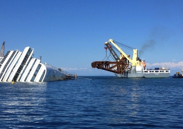

In April, the largest subsea platform used to upright the ship was installed as salvage efforts move forward. Photo: Parbuckling Project

Crews today are installing the last of six subsea platforms on which the ship will rest once upright. Each platform measures about 32 feet long by 22 meters high and weighs about 1,000 tons. The platforms are supported by large pillars that are attached to the granite seabed at a depth of about 10 meters.
Also in progress is the installation of high strength grout bags and mattresses, required to fill the gap between the two spurs of rock on which the wreck lies.
In addition, two of the eleven sponsons, or caissons, have already been positioned, welded and attached on the port side of the ship. The sponsons, built by Fincantieri, are large watertight boxes made of steel that will filled with water, providing leverage during the parbuckling, and then emptied, providing for flotation. Another 9 sponsons still need be positioned prior to the parbuckling. In total, 15 sponsons will be installed to each side of the ship prior to refloating.

The parbuckling is easily the most anticipated phase of the removal process. It will be performed using strand jacks which will be tightening several cables attached to the top of the sponsons and to the subsea platforms. This is a very delicate phase, during which the forces involved have to be offset carefully to rotate the wreck without deforming the hull.
