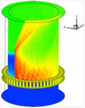

NRL researchers have constructed a model of a Rotating Detonation Engine.(Photo: U.S. Naval Research Laboratory)

The Rotating Detonation Engine (RDE) is an even more attractive and different strategy for using the detonation cycle to obtain better fuel efficiency. NRL researchers have constructed a model for simulating RDEs using earlier work done on general detonations, as a foundation.
